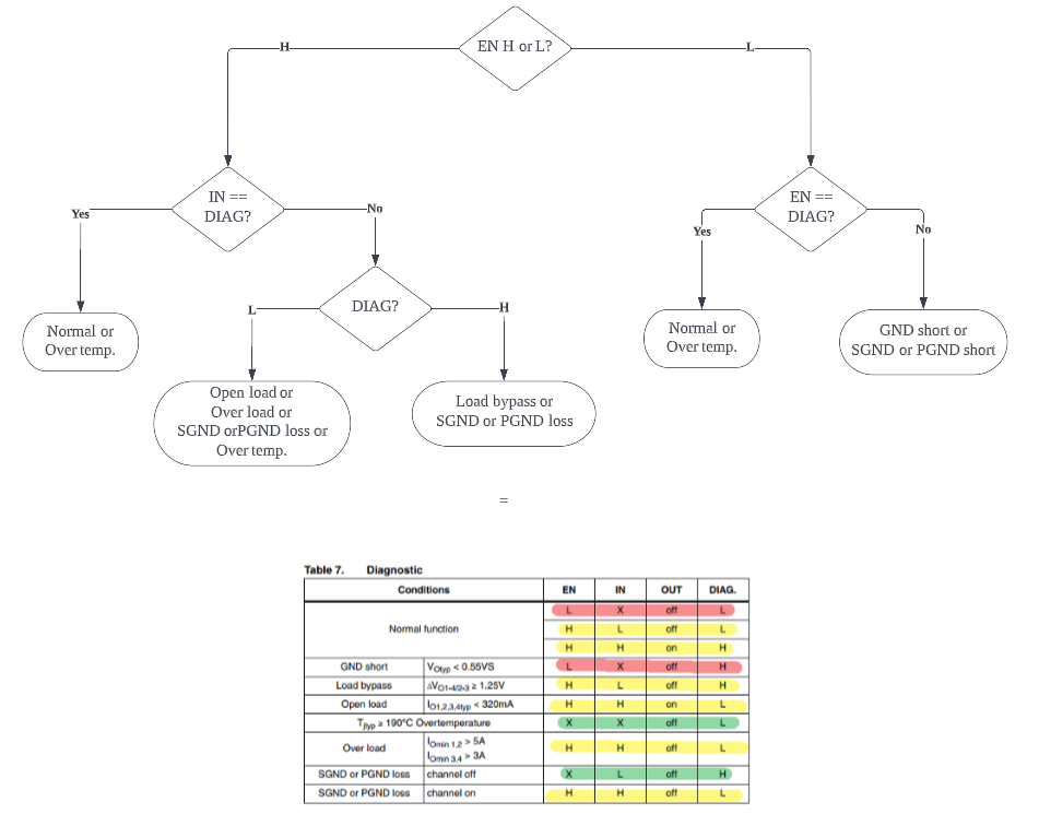

- I have tried to lay out all the diagnostic logic on diagram. It seems their conditions will overlapped with each other (especially open load and overload), have I missed something? If not how to do diagnostic then?
