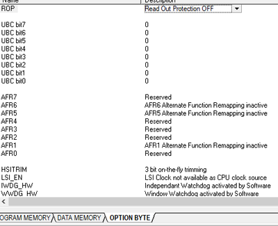

2023-06-20 10:24 PM
If you are using STVP then go to option byte Select Read Out Protection OFF , select program in upper box and click program the current tab.
