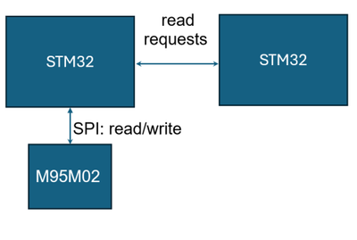

I think better to let one STM32 accessing exclusively that memory and let the second MCU communicates with it to request reading the data from the memory.
