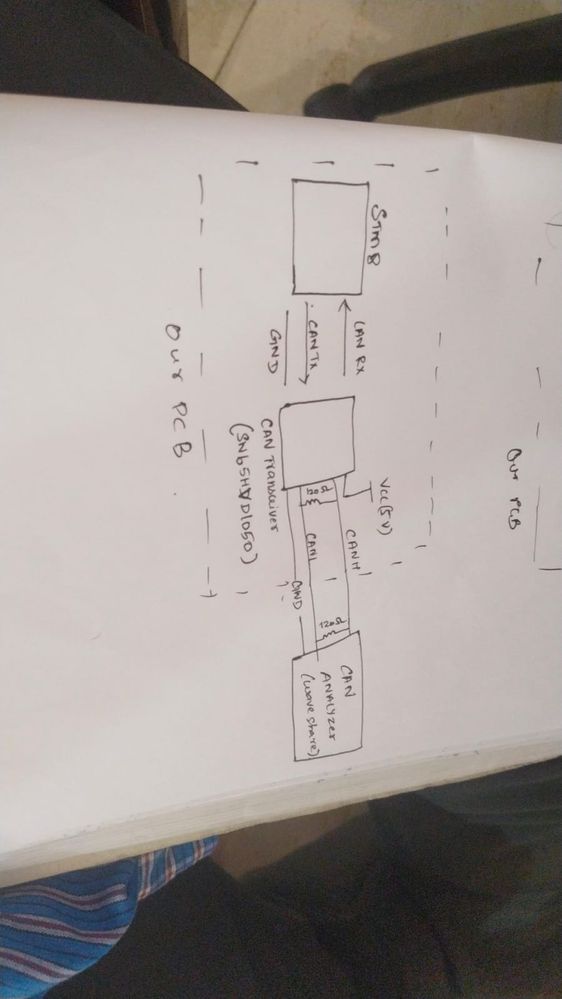

I am working with STM8AF5268 and implementing CAN communication using the STM8S/A Standard Peripheral Library.
MCU: STM8AF5268
CAN Transceiver: SN65HVD1050
CAN Analyzer: Waveshare USB-CAN-FD
Baud rate: 100 kbps
120Ω across CANH and CANL at STM8 side
USB-CAN-FD termination enabled
Measured ≈ 60Ω across CANH–CANL
SN65HVD1050 VCC = 5V (verified).
Common ground connected between STM8 board and analyzer.
When attempting transmission, the CAN controller enters Bus Error / Bus-Off state.
No frame appears on the USB-CAN-FD
When sending frames from the USB-CAN-FD tool at 100 kbps, the STM8 does not receive any frames.
RX interrupt is not triggered.
I am using STM8S/A Standard Peripheral Library for CAN and interrupt handling (stm8s_it.c with proper vector configuration).
What are the common reasons for Bus-Off during transmission on STM8AF52xx?
Is there anything specific required in STM8AF52xx CAN initialization before transmitting?
Could incorrect bit timing configuration cause immediate bus errors?
Are there any specific hardware-level checks for STM8AF52xx CAN (TX/RX pin configuration, alternate function setup, transceiver standby pin handling, etc.)?
If anyone has experience with STM8AF52xx CAN, please guide me
thank you (i attach the file for reference)

Second, Bus-off state mainly occurs with a hardware issue: wiring issues or an issue with your transceiver.
Or bitrate issue config i.e. bitrate mismatch.

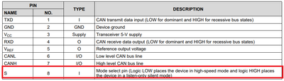

- Check is the S pin of your transceiver: is it connected to the GND?
- Check also the power supply of your transceiver on its pins directly.
- Check all your wiring with a continuity test with your device powered off.
- Check your bitrate it should be exactly the same for all the nodes (no approximative bitrate values).
- Try the Loopback mode to confirm whether it is a hardware issue. If Loopback mode works it's a hardware issue or a bitrate mismatch issue.

I have successfully received the CAN messages. The issue was identified as a hardware-related problem rather than a software fault.
