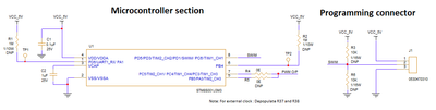

We have provided SWIM, 5V, and GND connections to the microcontroller for programming and debugging purposes.
Is it possible to program the ST8S001J3M3 MCU using the ST-Link V2 or V3 via the 5V, SWIM, and GND connections?
Please find the attached reference schematic for your review.
Additionally, if there are any recommendations or required corrections in the schematic related to programming connection, kindly let us know.
We look forward to your valuable response.

With your assignment of SWIM, VCC and GND, you can debug and program, but only with ST-LINK/V2, ST-LINK/V2-1 and ST-LINK/V2-ISOL, not with ST-LINK V3.
Please note: there are many illegal clones of ST-LINK/2, for which functionality cannot be guaranteed (see, for example, the discussion about clones, even if it initially concerns the target platform STM32).
