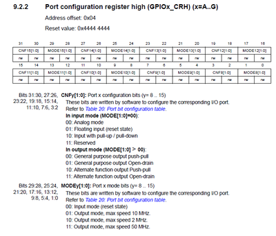

what is the CRH register? seems not consistent with the Reference manual.
and are you sure you are setting the GPIO output mode?
and also need to replace the return 0 with while(1).
2025-09-07 5:57 PM
seems the GPIOC->CRH &= ~((1<<22) | (1<<21)); should be
GPIOC->CRH &= ~((1<<22) | (1<<23));

I did make such a mistake. After fixing bit register 21 -> 23, the LED turns on at
GPIOC->CRH &= ~((1<<22) | (1<<23));and turns off at
GPIOC->BSRR = (1<<13);which is weird because it turns on while setting the register and turns off when setting the set-bit = 1.
