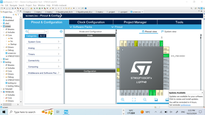

im using STM32F103C8T6 , Im using it without any problem but yesterday i upload code , the code is not correct then i make some changes and upload again then it showing this error i use both ST-LINK UTILITY and STM32CubeProgrammer , i follow some solution in this website but is not working for me . look forwad for your reply thank you

Have you disabled the pins used by the SWD connection?

im using ST-LINK V2 , i didnt disable the pins
im trying to connect PB10 and PB11 after i enable the pins i upload the code using Hex file to the STM32F103C8T6
