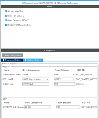

I use X-CUBE SAEFA1 to run the Authentication routine in STSAFE-A110 on stm32l151, the serial port returns 6 or is stuck, ask for help

Hi @ll132435 ,
I'm trying to reproduce your test on a nucleo L152 board.
In the mean time I see that you are not allocating much memory to the heap and stack.
When using MbedTLS, you may need more memory, could you have a try with the a heap of 0x2000 and Stack of 0x4000 ?

Hi @ll132435 ,
I have tested on STM32L152 with your IOC project and it's working fine.
Could you please try to capture the I2C communication if any on your board ?
