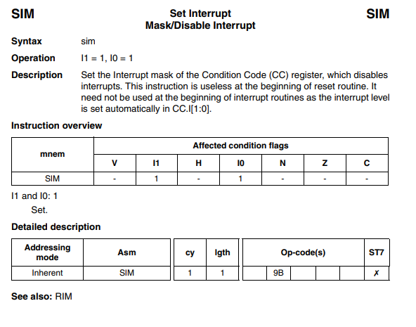

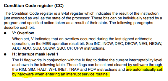

Hello @jduo.1 ,
Are you sur that no interrupt happened while you're stepping?
Could you disable the interrupts using SIM and retest your code?
Disclaimer: I've never used STM8, I've just skimmed through PM0044.
