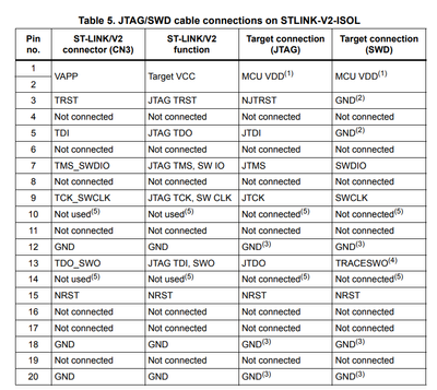

according to manual we have made the connections shown below:
| Relay module | ST-LINK/V2 ISOL (20 pin) pin no. |
| 3v3 | 1 |
| GND | 12 |
| SWIM | 7 |
| RST | 15 |
I have tried both the RST pins (15th and 3rd).
Also, i have tried the (5th, 7th, 9th and 13th pins) for SWIM connection but, not worked.
Please suggest the solution.
Thanks, and regards.
Saurav.

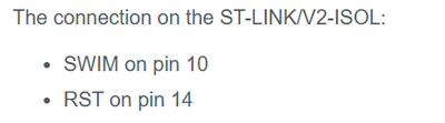

2025-04-04 1:50 AM
The connection on the ST-LINK/V2-ISOL:
Regards
/Peter

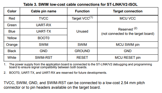

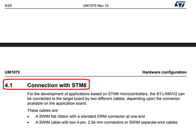

2025-04-04 2:10 AM - edited 2025-04-04 2:12 AM
@saurav wrote:
As the title of that table says, That's about JTAG/SWD.
The STM8 does not use JTAG/SWD - it uses SWIM.
@saurav wrote:Does ST-LINK/V2- ISOL is Right for STM8 controllers .
Yes - see section 4.1 in the User Manual:
via: https://www.st.com/en/development-tools/st-link-v2.html#documentation
The SWIM connections are shown in Table 3:

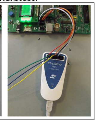

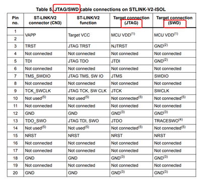

2025-04-04 2:29 AM - last edited on 2025-04-04 2:31 AM by Andrew Neil
Yes,
Mr. Andrew
Earlier I have checked this also.
but see below:
As Mr. Peter said.
And if you look at the image below the Orange and White colour pins are already connected on 10th PIN which is SWIM and 14th PIN which is RST.
So, i have connected the SWIM on 10th PIN and RST on 14th pin which is also shown in above image.
but still the issue is occurring.
Saurav Koli.
2025-04-04 2:37 AM - edited 2025-04-04 2:38 AM
That's the photo from the ST Manual.
Please show a photo of your own setup.
The schematic of your board would also be helpful.

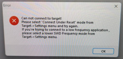

The screenshot you showed earlier:
Says SWD - again, the STM8 does not use SWD !
Please see How to take screenshots in Windows - rather that photographing the monitor!
