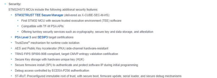

Hello @bsuthar ;
According to the STM32H563/STM32H573 product page only STM32H573 MCU include PSA Level 3 and SESIP3 target certifications:
Thank you.

Okay , thank you @KDJEM.1 ,
Among all STM32 MCU , STM32H573 is most secured device in terms of Firmware protection , Correct ?
