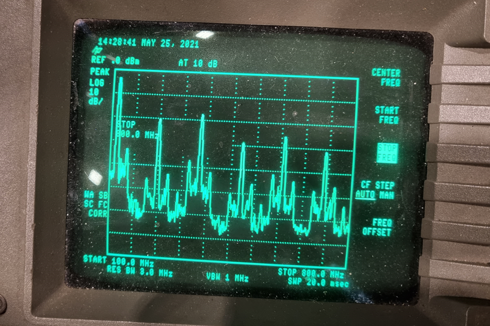

We are getting massive ammounts of emissions from the D0 SDIO pin with 120mhz and resonant freqs. The pins for SDIO have been set to AF but nothing else has been setup register wise yet, the circuit was taken from the appnotes with the 3v3 pullups on D0,1,2,3,CMD
APB2 periph is 60mz
APB2 timer 120mhz

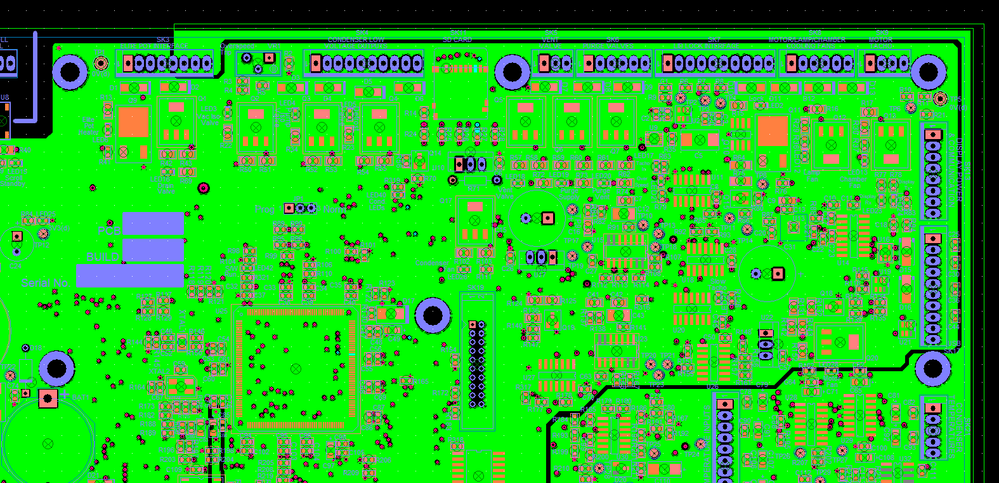

How about you show us your PCB layout or something.

How do you know the noise is comming from the SDIO pins?

top and bottom copper
Ground plane in between

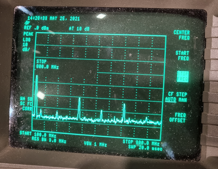

We probed the pins with an analyzer this is directly probing the D0 pin
This is probing both pins next to D0

Besides of possible configuration and wiring issues with the SDIO pin, the PCB track seems to function as a perfect antenna for said frequencies, i.e. length and impedance matching seem to favour such transmissions.

wow,
no idea of where the SDIO pins are in your pcb, but it looks like a noise playground for high frequencies.

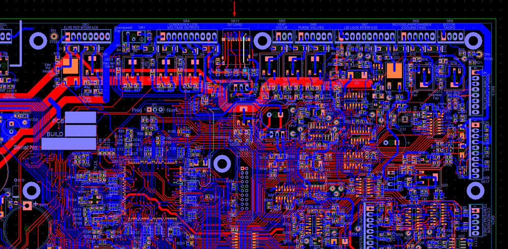

I tried to highlight the D0 net in light blue goes to the SD socket on top with the red arrow.

Do you suggest keeping the track lengths to a minimum?

ah yes i see them now.
Im not an expert aboutPCB routing, did you followed any design rule?
Like length matching , smooth angleless shapes or clearance between traces

Yes, we go through a DRC before releasing the board.
The EMC engineer we spoke to at the test facility implied that there is something fundamentally wrong,
as the emission levels are huge and could not be contained even by enclosing the PCB in a metal cage.
