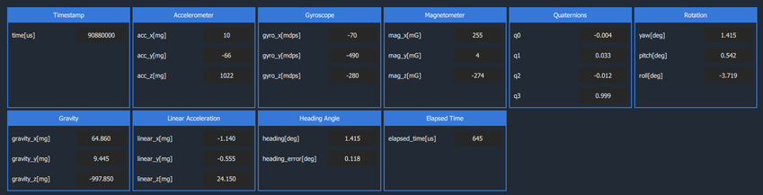

Well, thanks to the tools available today (thanks AI) the problem was solved, the problem was the different units I was using did not match what MOTIONFX was expecting and other calibration issues, hopefully this will help somebody in the future, here is the final code used:

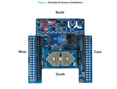

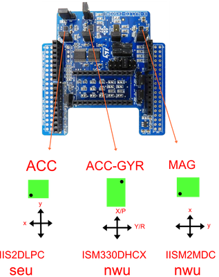

I just had to really zoom into the chips, impossible to see letter but I can see the markings of pin one on the board and the chip, I thought that I had something else to share but my tests so far are not going well as I don't know how to set my reference. The letters NWU and SEU is how I think I need to set them in the MOTIONFX library, but the test are not going good, what I do is Test the Fusion Heading (ism330/iism2mdc) against the raw reading of the Magnetometer in degrees they should be close but so far North is good using NWU/Gyro-Acc and NSU -MAG- the rest is 90degrees off, but I can fix it because I'm guessing.

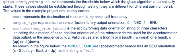

For example, the document Getting started with MotionFX sensor fusion library in X-CUBE-MEMS1
expansion for STM32Cube, gives the data for the IKS4 but where is for the rest of the boards? or in this case the IKS02A?

After many hours and following some ST examples, the orientation string of the board is in the iks02a1_mems_control_ex.c right here: (I just have 5 days with the board and I have never used STM32 before so excuse me if you see many errors)
#include "iks02a1_mems_control_ex.h"
* @brief Get accelerometer sensor orientation
* @PAram Orientation Pointer to sensor orientation
* @retval None
void BSP_SENSOR_ACC_GetOrientation(char *Orientation)
Orientation[0] = 's';
Orientation[1] = 'e';

BSP_SENSOR_ACC_GetOrientation(MotionFX_knobs.acc_orientation);
BSP_SENSOR_GYR_GetOrientation(MotionFX_knobs.gyro_orientation);
BSP_SENSOR_MAG_GetOrientation(MotionFX_knobs.mag_orientation);
And then definie the type of output ENU or NED:
//Fusion output convention (ENU) MFX_ENGINE_OUTPUT_ENU
MotionFX_knobs.output_type = MFX_ENGINE_OUTPUT_NED;But even after this changes I can't get the same Fusion heading as the heading provided by the magnetomer and my output data do not match MEMs studio data output, here is the main code used in app_mems.c in CubeIDE, the code will wait till the magnetomer is calibrated doing an 8 and getting GOOD quality, it will print based on the desire rate set up in the program to not flood the screen with messages, but the ODR is 100Hz

I was testing the output between ENU and NED output, here is the NED output. The board is pointing North and the Fusion Heading and direction of some axes do not match the output of MEMs studio, the output is Quaternion, Rotation, Gravity, LinearAccel and Heading.

ENU output is more similar to the one I get in MEMs studio:

MEMs Studio (My terminal units vs MEMs studio are different for G and LinAcc)
Why I can't get the heading correctly? Why in my output the Yaw is wrong?
