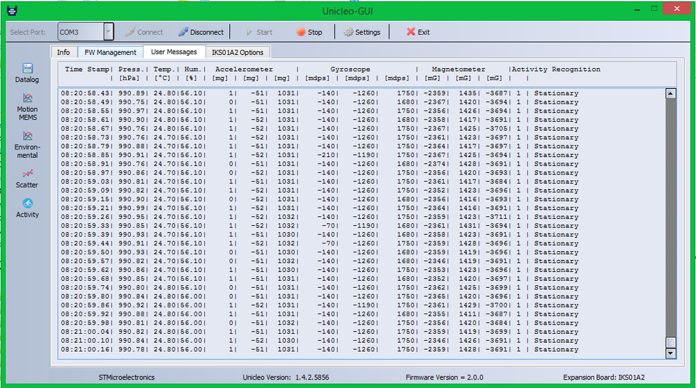

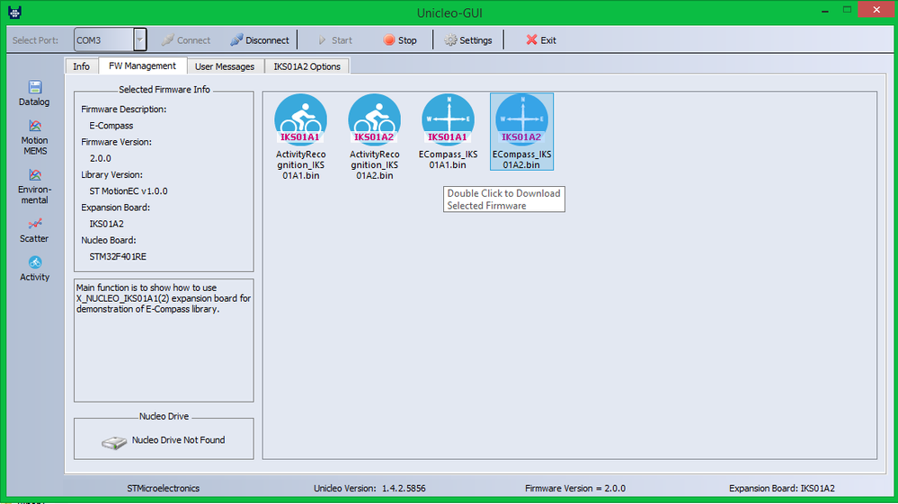

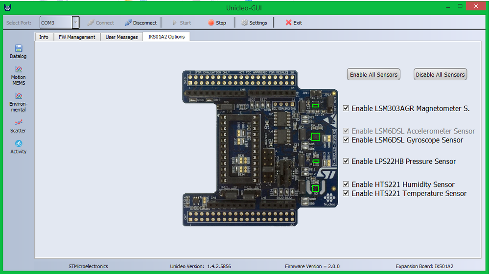

I have put some binary files to that folder and they are appered in Unicleo, but I can't to download they to board by double click, what's the matter? Also, I can't change or read device registers value in ''IKS01A2 Options'' as you at the video. Also, I have see inscription ''Nucleo Drive Not Found'' in FW Managment tab although I have got data from device via VCP as it can see in screeshot of ''User messages'' tab. What need I do to fix that situation to proper?
2018-06-19 3:40 AM
The possibilities to change ODR, FS and read and write to registers are only in DataLogExtended firmware.
It is strange that the Nucleo Drive was not recognized. I suppose you are able to program the Nucleo by copying the binary to the Nucleo driver in explorer, right? Maybe you can try to update the ST-Link firmware using the STM32 ST-LINK Utility.

Can you please try it after you click on Disconnect button. Anyway we have discovered some issue in Unicleo-GUI and we will fix is in coming days.
