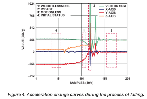

From reading material on human fall algorithms, I get the feeling that the MotionFD algorithm will be like the implementation described here https://www.analog.com/en/analog-dialogue/articles/detecting-falls-3-axis-digital-accelerometer.html
As can be seen in the graph copied from the article, the algorithm relies on data from before free fall is reached to confirm a fall has been detected.
Which would mean that our approach, of only recording from the start of free fall would be flawed. Since we are not providing enough data to the MotionFD library.

Miroslav BATEK
I'm afraid that the MotionFD is not suitable for your needs. To properly detect the fall it requires to pass several conditions (initial state - with vertical orientation, free fall, impact, change of height, motionless - with horizontal orientation). MotionFD uses also pressure sensor to detect change of height.
I guess in your case you can wake-up the MCU by the detected free fall and then monitor the acceleration and detect possible impact (high acceleration then certain threshold).
