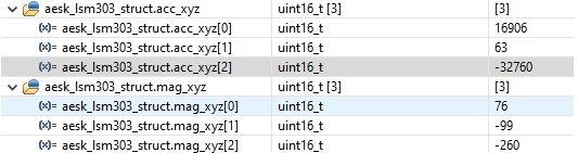

I have a LSM303D, compass, and acceleration sensor. I can communicate with the sensor, and I get the magnetometer data on all of the axes, unlike the accelerometer. Accelerometer Z-axis data comes "-32760" all the time. I work on stm32f103c8t6

And, here is the sensor data.
 0693W000007BYC6QAO.jpgWhat can be the problem? I think the initialization can be different, but I couldn't find what should I change.

so is the z-axis acceleration value (and not x-axis and y-axis) always stuck to the -32760, right?
The device seems to be correctly configured, but please note that you are using uint_16 variables while signed int_16 should be used, according to the LSB to physical units conversion formula (check also the endianess, the order of the MSB and the LSB, etc...):
float_t lsm303d_from_fs2g_to_mg(int16_t lsb)
  return ((float_t)lsb * 0.061f);
You can also try to set the BDU bit of CTRL1 (20h) register to avoid overlap in the MSB/LSB values during concatenating....

"so is the z-axis acceleration value (and not x-axis and y-axis) always stuck to the -32760, right?" Yes, but I've noticed that sometimes it comes 8. So, the Z-axis accel value always stuck to -32760, and 8.
I've changed "uint16_t" to int16_t, but the result is the same as before. Also, I've tried to change CTRL1 register value. I've written 0x5F to CTRL1 but, the result is the same as before. (Also I've observed these values on stmstudio.)
I guess I must change the IC with another type. There is a possibility that if I test this with another LSM303D I would get the same result.
