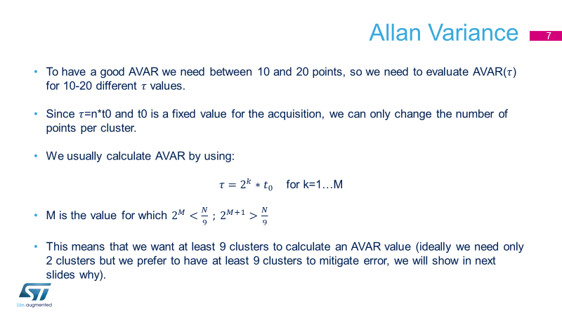

Hi @KJ.2ose ,
I can share you our prescription in terms of Allan variance calculation:
This should help you about the calculation for the Allan variance.
