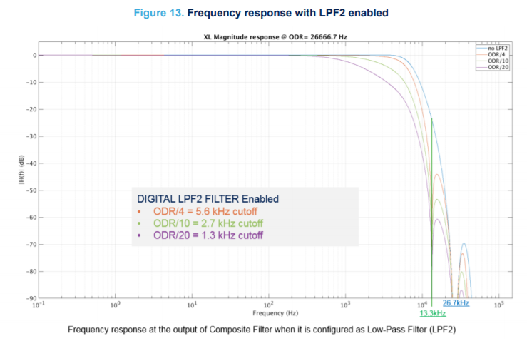

Consider the IIS3DWB datasheet, p. 20: here the transfer function (frequency response) of the filter is the following one:

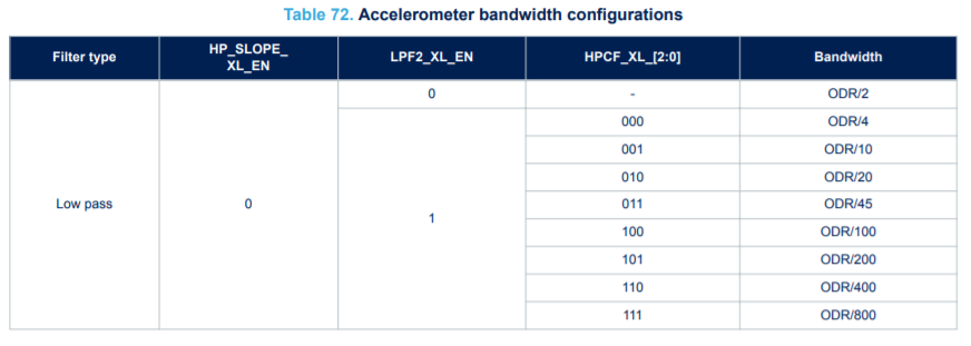

There are 2 main parameters of this filter that you can adjust: the frequency pole, which is determined by ODR/2 (which is fixed at 13.33kHz for the IIS3DWB but can vary for the LSM6DSOX), and the slope of the filter, which is determined by the (adjustable) cut-off frequency (the -3dB frequency), that can be ODR/4, ODR/10 and ODR/20 for the IIS3DWB, and as described in the Table 72. (at p.63 of the datasheet) for the LSM6DSOX:

Is it possible to have the frequency response plots of all the cutoff configurations? As you mentioned, on the datasheet only the first three curves are shown.
