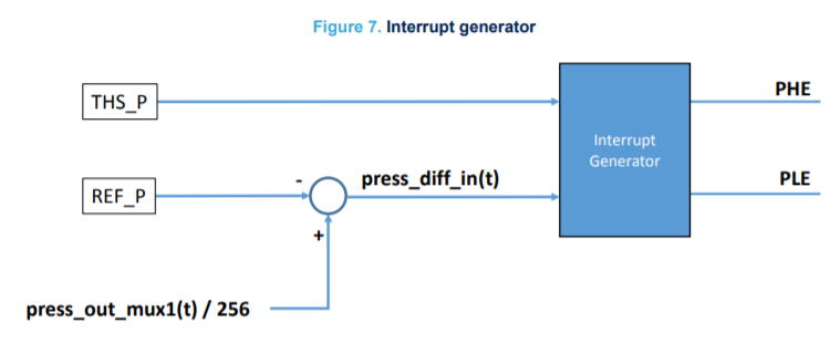

Hi @Xxia.1​ ,
please consider the application note AN5387, p.18.
It states that the threshold crossing refers to the reference pressure value that can be configured in the REF_P_L (15h) and REF_P_H (16h) registers (that in your case are left to the default 00h value, and are described in the datasheet, p. 40).
More specifically, the calculation performed by the interrupt generator is the following one:
  • P_DIFF_IN = measured pressure - REF_P
  • PRESS_OUT = measured pressure - REF_P
0693W00000AOkAVQA1.pngCan you try with configuring this additional registers?
