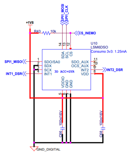

If otherwise you want to exploit the embedded feature of the LSM6DSOX for the free fall detection as explained in the app note AN5272, p.42, you can exploit the INT1_DSR and INT2_DSR pins from the schematic:

If you want to use the Sensortile.box as a free fall detection tool using the the LSM6DSOX, I suggest you to start from an existing FW, configure the LSM6DSOX for the free fall detection and then enable a LED (for example the green one).
You can do it as described in the previously linked video.
You don't need to run the MLC, in principle.
However, if you are interested in a more complex pattern recognition (such as a particular man-down), you might need to set up a more complex configuration.
In this case, on the BLEMLC section (p.17 of the user manual UM2626), and from slide 280 of this presentation you can find more information for a starting point.
