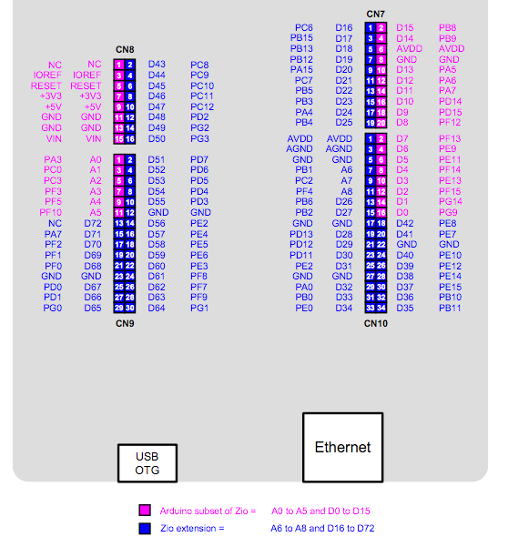

Hi, the X-Nucleo expansion boards like the AMICAM1 or the IKS01A3 are compatible with the Arduino R3 connector, that is both on stm32 Nucleo 64 and 144 boards. Check the purple connections here below, above which you can plug the various X-Nucleo expansion boards.
