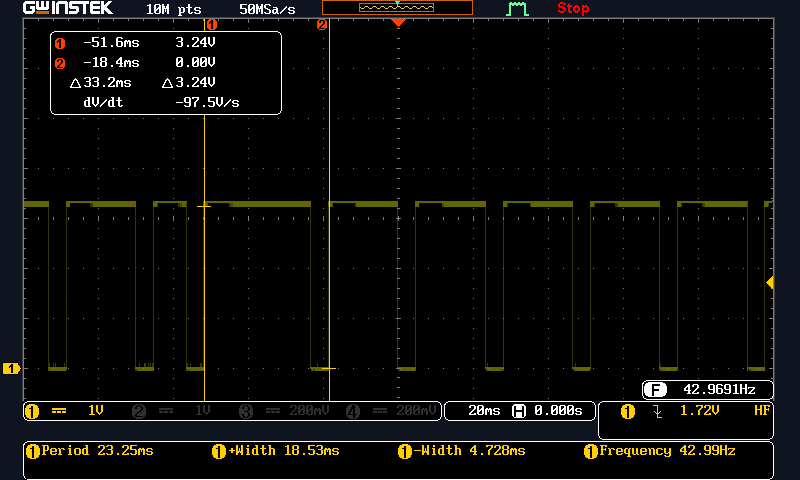

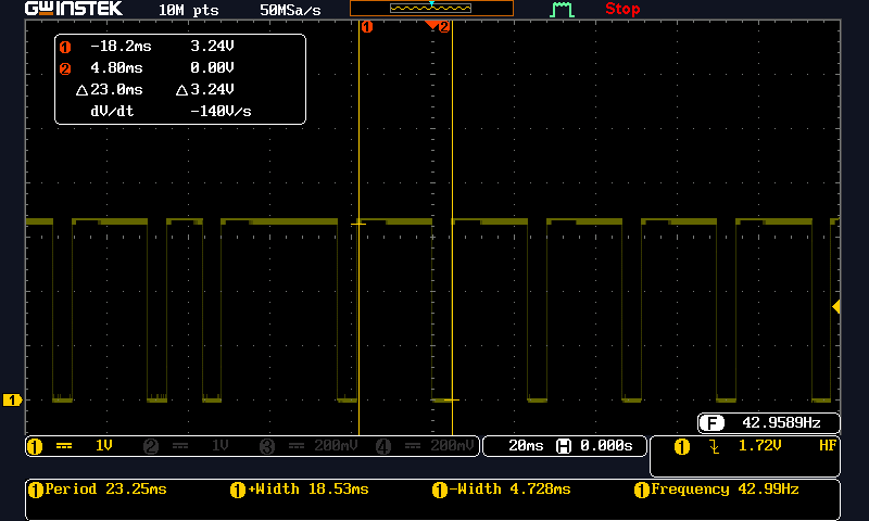

I'm developing an applications where an array of VL53L1X sensors would be used. During that development effort it became apparent that there were some timing issues while cycling through the sensors and when I expected them to complete ranging. I reverted back to the
's example code while troubleshooting this issue. The P-NUCLEO-53L1A1 (X-NUCLEO-53L1A1 & NUCLEO-F401RE) development boards are being used with only the center sensor in place. The modifications made to the example code are the following:status = VL53L1_SetDistanceMode(Dev, VL53L1_DISTANCEMODE_SHORT);
status = VL53L1_SetMeasurementTimingBudgetMicroSeconds(Dev, 20000);
status = VL53L1_SetInterMeasurementPeriodMilliSeconds(Dev, 10);
// status = VL53L1_GetRangingMeasurementData(Dev, &RangingData);// if(status==0){// printf('%d,%d,%.2f,%.2f\n', RangingData.RangeStatus,RangingData.RangeMilliMeter,// RangingData.SignalRateRtnMegaCps/65536.0,RangingData.AmbientRateRtnMegaCps/65336.0);// }Based on Figure 3. VL53L1X autonomous ranging sequence and timings and section 2.5.2 Timing budget and inter-measurement period (particular the below note) from
http://www.st.com/resource/en/user_manual/dm00474730.pdf
, I would have expected the falling edges from the GPIO1 interrupt line to be spaced by 20ms independent of the object placed in front of it.Note: If the inter-measurement period is shorter than the timing budget, once the device
completes the ranging, the next ranging starts immediately.Probing the GPIO1
interrupt
line resulted in the attached plots. When no object was placed in front of the sensor the time was 28ms, and when an object was placed in front of the sensor the time varied between 28ms and 37.1ms. Can anyone offer any explanation for this or point out where my misunderstanding of the documentation/API functions is? Timing is very critical in my application especially when obtaining consistent results from multiple sensors.Thanks,

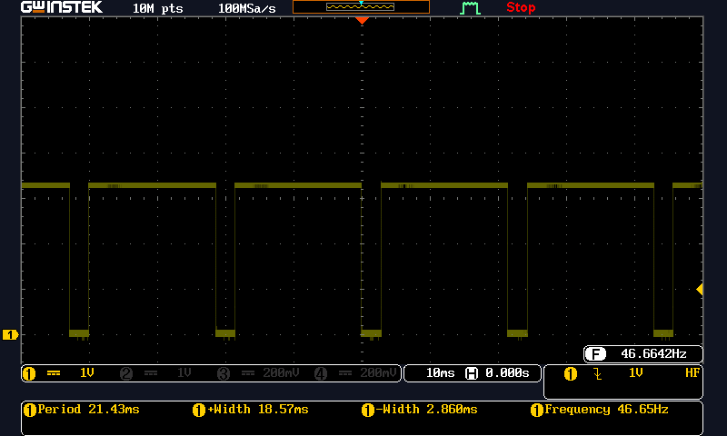

I've changed the parameters using the recommendation you specified.
status = VL53L1_SetInterMeasurementPeriodMilliSeconds(Dev, 23);
// status = VL53L1_GetRangingMeasurementData(Dev, &RangingData);// if(status==0){// printf(''%d,%d,%.2f,%.2f\n'', RangingData.RangeStatus,RangingData.RangeMilliMeter,// RangingData.SignalRateRtnMegaCps/65536.0,RangingData.AmbientRateRtnMegaCps/65336.0);// }The time between starts and in-turn the time between
the GPIO1
interrupt
line falling low indicating ranging data ready is much closer to the expected value, being 21.43ms.
There is still the issue of this time varying though when an object is placed within the FoV of the sensor. When the object (white paper) is very close to the sensor (roughly less than half an inch away) the time remains around 21.43ms. As soon as the object moves above that distance this time doubles to 42.85ms. The datasheet specifies that a 50 Hz ranging frequency should be attainable with a 20 ms timing budget in short distance mode.

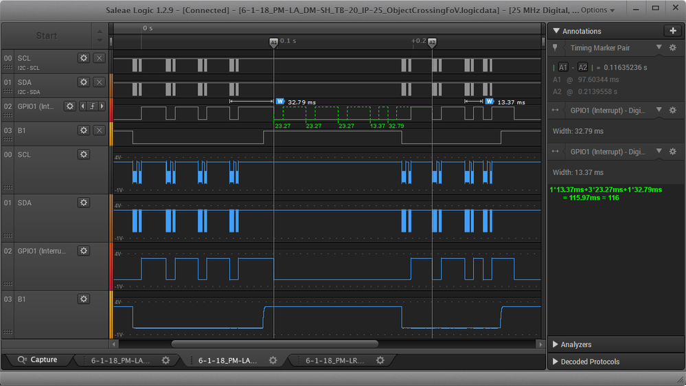

With the above settings, ~3ms time between measurements was achieved. Three things were observed with the above setup.
An object (white paper) was approximately 360mm from the sensor. When the full 16x16 ROI was used the distance being reported was between 357-362mm. When the ROI was changed to a centered (not necessarily optically centered...) 4x4 one the distance being reported was between 327-336mm. I've read through the explanation provided in the following thread:
https://community.st.com/s/feed/0D50X00009XkVt1SAF
I haven't yet performed offset calibration to see if this minimizes the issue.
When an object enters/exits or crosses the sensors FoV the time between measurements varies at that moment. Using the code above with nothing in the sensors FoV (aside from the ceiling of the room...) I moved my hand across the sensors FoV relatively close to the sensor. See Fig1a-c for the variation in time between measurements (2ms, 23ms, and 2ms).
Fig2 shows the readings obtained during a single instance of me moving my hand across the sensor.
This instance doesn't correspond to the same instance the scope images were taken; they are just used as an example.
I'm assuming the shorter time could be attributed to when a low signal rate occurs, potentially resulting in ranging error 2. What is the cause of this longer time? Is there a software solution to minimize this from occurring?
In our application objects are moving relatively quick to meet a spec'd throughput hence this being a concern.

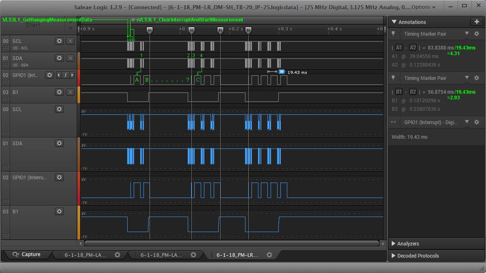

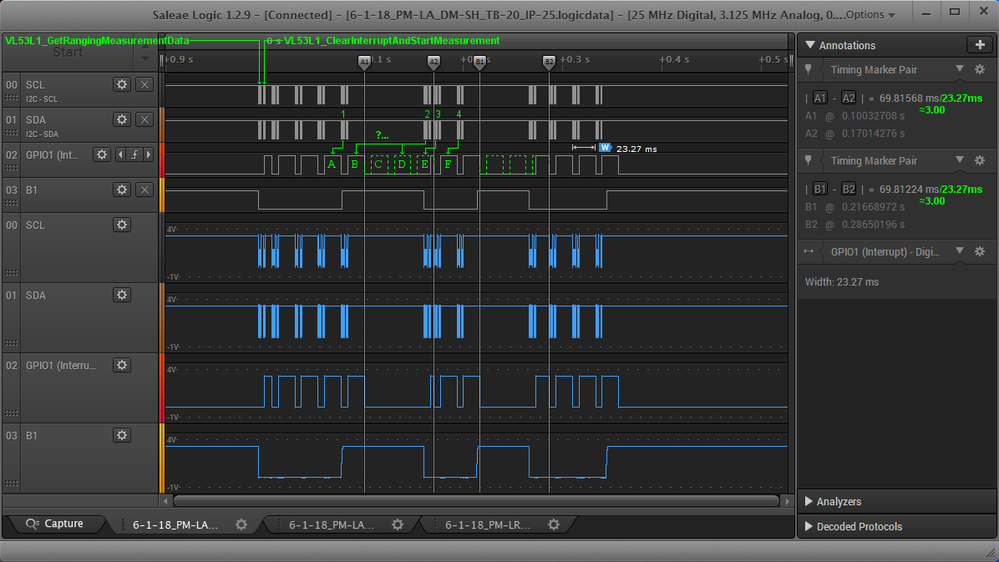

Below is when the
VL53L1_PRESETMODE_LOWPOWER_AUTONOMOUS preset mode is used and no object crosses the sensors FoV.
As expected the sensor is continuously ranging as you described represented by the
overlaid green ranging pulse times. I've marked particular instances when the VL53L1_GetRangingMeasurementData function is called with green numbers 1-4. Particular instances when the sensor is ranging are marked with green letters A-F.
The sensor's results register is updated with ranges from the labeled A range and obtained from the 1 GetRangingMeasurementData function call.
My confusion arise with respect to the results returned by the 2 GetRangingMeasurementData function call. I've seen two things mentioned with respect to this:
A clear interrupt is mandatory to allow the next ranging data to be updated. [DS12385 - 2.4 Ranging description]
To get consistent results, it is mandatory to call this function after getting the ranging
measurement.If this function is not called, the next ranging will start and the results will be updated. But,
the data ready status flag will not be updated, and the physical interrupt pin will not be cleared. [UM2356 - 2.4.6 Clear source of interrupt]These two statements are contradictory. If the first statement is true I would expect the 2
GetRangingMeasurementData function call to return ranges from the B ranging. If the second statement is true I would expect the
2
D ranging.
Can you clarify which of the two is actually occurring?
As mentioned prior there is some variability with respect to ranging times due to objects crossing the sensors FoV and associated range result errors being generated as shown below.
The speculated overlaid green ranging pulse times could be permutated in any order. This issue is minimized when

VL53L1_PRESETMODE_LITE_RANGING
the timing budget doesn't corresponding to the time the sensor is ranging. Prior you mentioned an approximate 10% error in the VL53L1_SetInterMeasurementPeriodMilliSeconds when using the
VL53L1_PRESETMODE_LOWPOWER_AUTONOMOUS preset mode.
Is there a scaling factor for the ranging time when using this preset mode?Similar notation is used as above. In this case an integer number of ranging pulses wouldn't fit between the times that the sensor is being serviced to obtain range results. This is expected based on your provided description; ranging won't begin until the VL53L1_ClearInterruptAndStartMeasurement function is called. What I didn't expect were the short pulses of the sensors GPIO1 interrupt line following this delay and calling the
. I would have expected the line to be high for approximately 13ms while ranging is occurring and then remain low while the results are obtained and interrupt is cleared again resulting in a 19.43ms high/low pulse time.Can you explain the reason for this short pulse designated near the green '?' below '2' in the image above?
I'm assuming the
2
GetRangingMeasurementData function call would return ranges from the
B ranging. I'm unsure what results would be returned by the 3 GetRangingMeasurementData function call since there was no time to perform a proper ranging.
Can you clarify which range results would be reported by the 2 & 3 GetRangingMeasurementData function call?
This pulse would add large overhead when using 'N' number of sensors if calling both the
VL53L1_GetRangingMeasurementData and
VL53L1_ClearInterruptAndStartMeasurement twice is required to obtain valid range results.
Understanding these nuisance with a single sensor will help me determine the best approach for selecting a preset mode, timing budget, and development of interrupt handling/scheduling for multiple sensor to optimize synchronicity/consistency for our particular application.

Matthew - This is getting too long to follow. Let's start a new thread next time.
The crux of your questions is are from the continuous nature of the chip. It runs until you stop it.
If you don't call
ClearInterruptAndStartMeasurement(), the device will still collect the data. As soon as you make the call, the data (which is already collected) will trigger the interrupt. Unfortunately the data will be a bit stale, having been collected just after the last data you read. So consider tossing out that sample. So to answer your last question 2 is collected immediately after 1 (before the gap). 3 would be collected after the gap, just after the 'glitch'.
The data is collected, but cannot be reported until you acknowledge the interrupt - so the sensor is stalled at this point.
>>>Can you explain the reason for this short pulse?
Having already collected the data, the sensor is just waiting for you to read the prior result, and it will immediately send you a new one.
Perhaps a better way to say it is the C measurement is done before the gap, and reported just after the gap, then the next measurement takes off.
