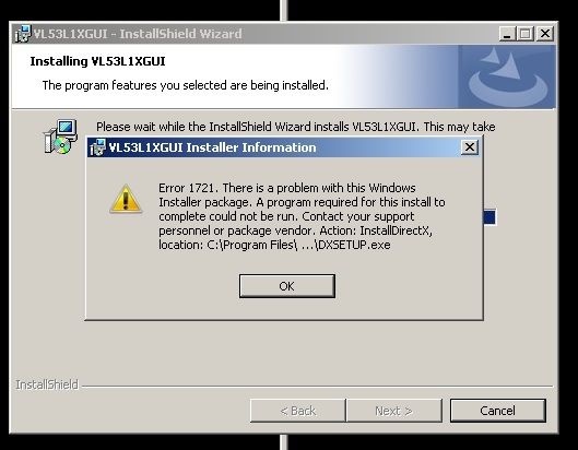

I have trying to install the VL53L1X GUI software in my desktop station but I cann´t do it because it shows me the next message:

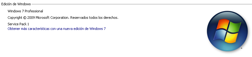

My OS is (windows 7 - 64 bits):

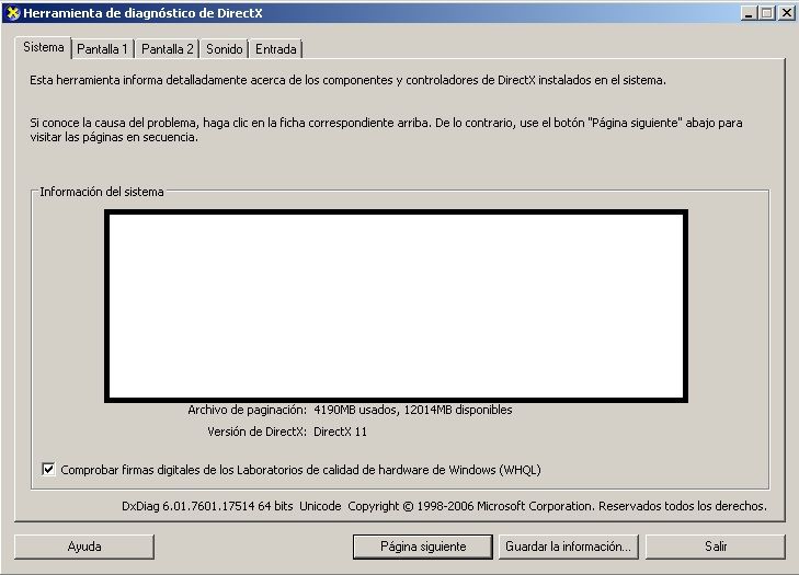

So have you tried installing DirectX?
2018-04-09 6:22 AM
Hi Clive,
Sure. If I run the program DxDiag it shows this form:
I?ve got the version 11.

I have run the ''VL53L1X_Setup.exe'' as administrator, the installation has finished succesfully. During the installation I have installed the DirectX (the version 10),
The VL53L1X GUI is installed but doesn?t work. Every time I run the program it shows the next dialog:

I had the same problem , it can be solved by changing the installation path from ''c'' to another one, for example desk ''d''.

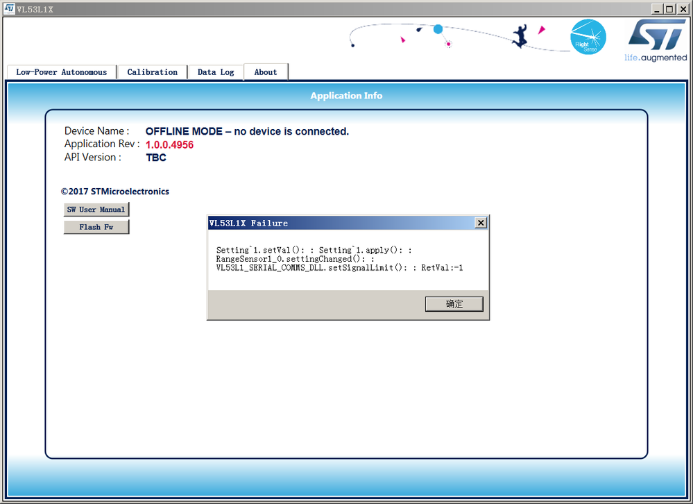

but i have a new problem:
When i connected the F401RE+53L1A1 evaluation board to PC and run VL53L1X_GUI, i got the following message:
so i could not do the Cal Ref Spads calibration and range measurement as well.
Any one know what to do next?
2018-06-07 7:15 AM
This is a Microsoft issue.
Here below the answer from Microsoft, but please first ensure that you are administrator:
would suggest you to try the methods below and check if it helps:
Method 1: Restart Windows Installer service
Restart the windows Installer service by following the steps below and check if it help:
1. Press Windows key + R to open the run command.
2. Type services.msc and press enter.
3. Right click on 'windows installer' and stop the service.
4. Right click again and start the service and try to install the program.
Method 2: Run the fix it tool
Download and run the fix it tool from the link below and check.
https://support.microsoft.com/en-us/mats/program_install_and_uninstall?ppud=4&wa=wsignin1.0
(Applies to Windows 10)Method 3: Install in compatibility mode
In order to identify if this is an incompatibility related issue, I would suggest you to try the steps below to install the program in compatibility mode by following the steps below and check if it helps.
1. Right-click on the setup file of the program and select 'Properties'.
2. Select 'Compatibility' Tab.
3. Place a check mark next to 'Run this program in Compatibility mode' and select Windows 8 from the drop down list.
4. Let the program install and then check the functionality
