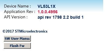

I have installed the latest available version from the ST web site:

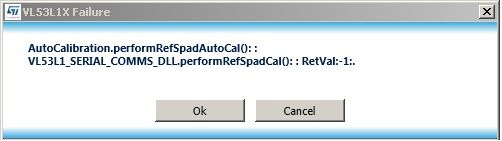

Everytime I try to begin a calibration it shows me the next message:
I have installed this software in 2 computers (W7 and W10), the error happens in both systems. So I couldn?t try this version.
2018-05-07 4:48 PM
Can you just skip the Cal Ref Spads and just continue. Your issue is not fatal. The GUI is just being over protective. A failure of this kind means the calibration was outside of the expected window. Turns out the window was just too restrictive.
But if you cannot continue, your only recourse is to use one of the satellite boards included with your expansion board. Very few sensors fall outside the expected limits.
And ST really should fix the 'error' to be non-fatal.
