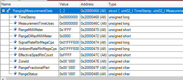

I tried stepping past it in debug and proceeding, but If I continue past the error and configure for single ranging (high speed measurements), the measurement completes with no error but the data is all maxed.
