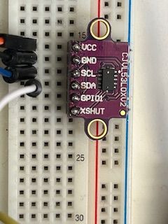

Hi John
thanks for reply.
The values are:
TimeStamp: 0
MeasurementTimeUsec: 0
RangeMilliMeter: 8191
RangeDMaxMilliMeter: 0
SignalRateRtnMegaCps: 0x1fffe00
AmbientRateRtnMegaCps: 0x1fffe00
EffectiveSpadRtnCount: 0xffff
ZoneId: 0
RangeFractionalPart: 0
RangeStatus: 0
I removed the protective film (I thought this would be the reason)...
John E KVAM
Those results make no sense. You simply cannot have an 8191 range and a RangeStatus of 0. So I'm thinking there is something wrong with your I2C interface. You think you are issuing commands but they might be byte-swapped or work swapped. All byte values are fine, but a word swap would be a huge issue.
When you took that picture did you see the flash of the laser? (Remember, don't use an Iphone.)
I'm betting the sensor is not on, and you are reading non-sense.
I have a bit of code to validate the byte and word swap, but it's written for the VL53L1X sensor. Perhaps you could adapt it. It is supposed to read the part ID, and then read and write values with differing byte-lengths to verify the access.
