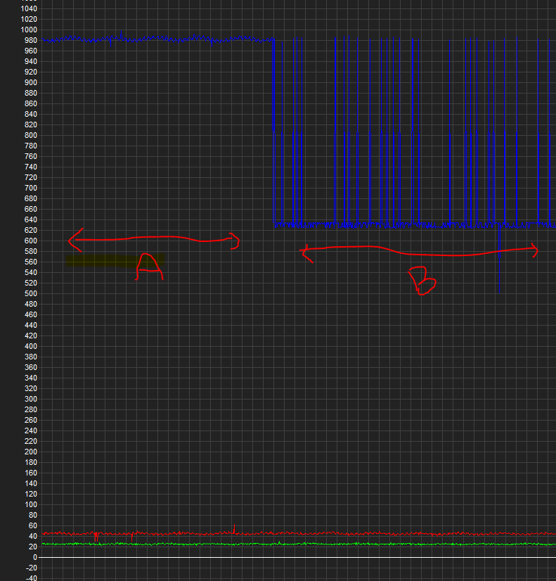

2020-10-14 5:03 PM
Hello...
Z-axis data fluctuates after block data update.
Look at the graph.
Block data updata enabale case (A) and block data updata disable case (B)
This is my sequence.
Are there any errors?
It seems to be the last question.
Thank you....
2020-10-15 7:25 AM
Hi @Kyouk.1 ,
trying to answer to your
Q2) The hpf adjustment changes position, but the signal is fluctuating.
Is there another way?
Please check this thread if can be of any help for you. The suggestion here is to properly set both HP and LP2 filters.
iis3dwb_xl_hp_path_on_out_set(&dev_ctx, IIS3DWB_HP_ODR_DIV_800);
iis3dwb_xl_filter_lp2_set(&dev_ctx, PROPERTY_ENABLE);
/* Into --> */
iis3dwb_xl_hp_path_on_out_set(&dev_ctx, IIS3DWB_XL_ODR_26k7Hz);
iis3dwb_xl_filter_lp2_set(&dev_ctx, PROPERTY_ENABLE);Q3) When the block data is updated, a noise signal is generated.
If the block data is not updated, the noise signal disappears.
Is it mandatory for you to have the BDU enabled?
-Eleon

2020-11-05 12:57 AM
Hi @Kyouk.1 ,
it's strange that with the high pass... did you correctly configured the HPCF_XL_[2:0] and the FDS bits of CTRL8_XL (17h) register? (See datasheet, p.36)
Another way to make the residual offset zero is to use the user offset compensation method. You have to measure the residual offset in a steady state condition and then write it in the X_OFS_USR (73h), Y_OFS_USR (74h) and Z_OFS_USR (75h) registers, so that the chip automatically subtract this value to the output. You have also to set the USR_OFF_ON_OUT bit of CTRL7_C (16h) register to enable this path.
-Eleon
