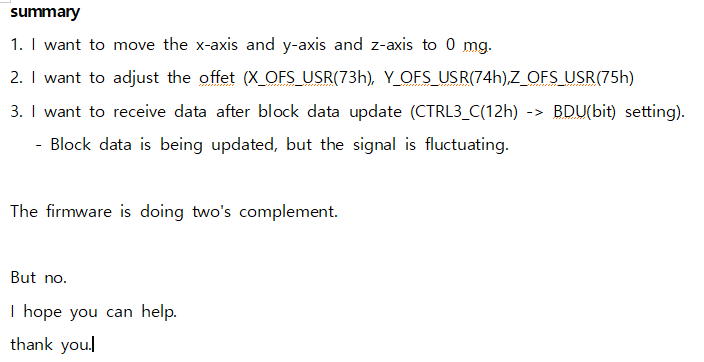

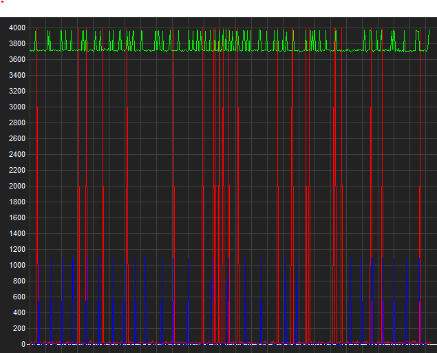

Additional questions.
1. When there is no vibration, the X-axis shakes up to 0.1(mg)~3996(mg).
(View : Capture1 & Capture 2)
Is it negative mg because the variable declaration is unsigned?
2. When vibration occurs, the amount of change in the x-axis and y-axis is large.
capture1
capture2 (X auxi : It changes rapidly.)
X auxi : red, Y auxi : green, Z zuxi : blue
capture3 : temperature(satisfactory fine)
2020-10-06 12:08 AM
I see in your last post that you are using Zigbee communication 230,400bps
IIS3DWB has output data rate of ~27kHz (27000Hz). Each axis has 16bit data so 16 x 3 (=3 axes) = 48.
48 x 27000 = 1,296,000 bps
1,296,000 bps >> 230,400bps and you have definitely some additional overhead what I see from the text log capture1
Is not it possible that you loose some data and that you bring inconsistency in the logs you are transmitting ?
2020-10-12 8:37 PM
thank you for the reply.
Q1) Can't you move X axis Y axis Z axis to 0 mg?
Offset cannot be adjusted.
Is there another way?
Q2) The hpf adjustment changes position, but the signal is fluctuating.
Q3) When the block data is updated, a noise signal is generated.
If the block data is not updated, the noise signal disappears.
result1.
X-axis result: 38mg~44 mg.
Y-axis result: (-_3940mg~(-)3936mg.
Z-axis result: 905mg~910mg.
X-axis result: 20mg~66 mg.
Y-axis result: (-)3996mg~(-)3916mg.
Z-axis result: 850mg~960mg.
