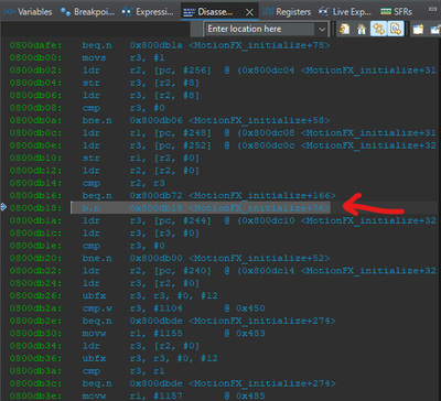

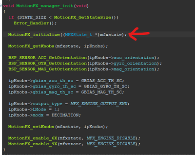

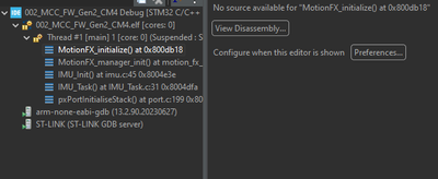

but after running, when a function is called from the MEMS1 libraries, the code is blocked !
i tried different example (fusion, magneto calibration, ecompas)

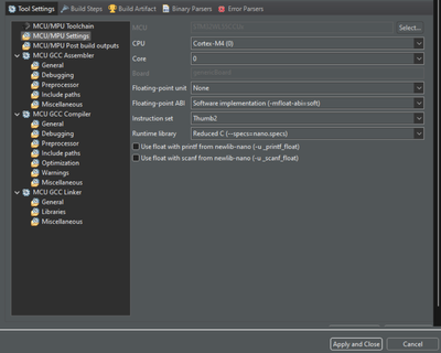

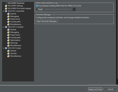

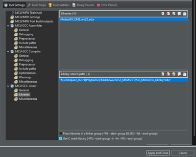

i am usin the CM4 of stm32WL55. this core don't contain a hardware FPU. i tested with xxx_CM3_wc32_ot.a and xxx_CM4_wc32_ot.a files
here are the setting of my compiler :
it is blocked in the first call of any function from xxxxx_wc32_ot.a files
