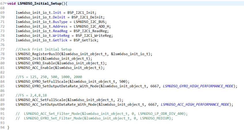

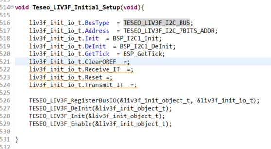

Hey :)
Im trying to use LIV3F with F303RE board. I have trouble to configure the LIV3F. Can it be setup like LSM6DSO for example? Here is how I did this:Can the same method be applied to LIV3F? If so, what is ClearOREF, Receive_IT, Reset and Transmit_IT?
