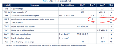

May I know what configuration to set on sleep mode on sensor SPI( IIS3DWBTR) to get power consumption(5-16uA), I am using SPI interface to MUC(STM32L562 controller)
As per datasheet 5-16uA, please suggest SPI pins configure for sleep mode.

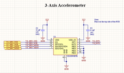

please check below circuit for your reference

the 5-16 uA of current consumption are in power down mode, this means that you should not turn on the device to have that power consumption.
if you have a high power consumption while the device is powered off, maybe there are some other problems in the schematic of the board.

the schematic part of the sensor itself is not so useful, the connections to the STM32 is important as well
