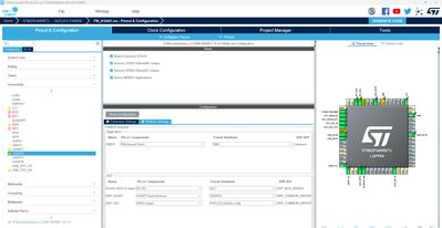

I followed line by line the instructions provided in the "Getting started with the STMicroelectronics X-CUBE-MEMS1 software package for STM32CubeMX". My cube project locks like this:

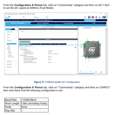

I would point out that in the IKS4A1 Getting Started guide it is said to set the UART speed at 115200 (page 53 and page 60) and the CubeMX when builds for the IKS4A1 sets the speed at 115200:

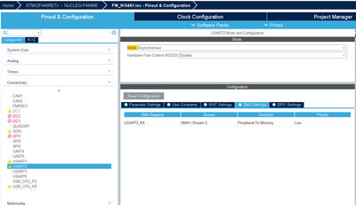

I enabled the CRC but if you don't set the DMA as below, you will get an hard fault:
