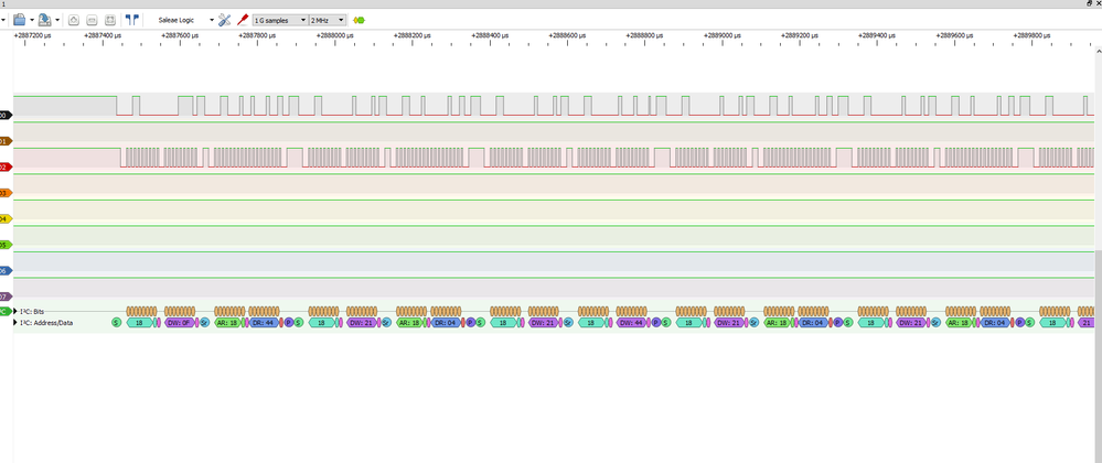

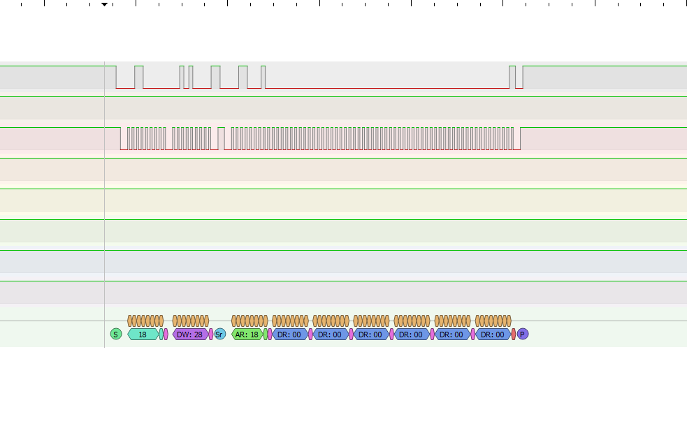

I'm still unable to figure out why the nrf52840 is receiving zeros but the Nucleo is able to read the data. Just a reminder that I was able to read the WHO_AM_I register with the nrf52840.
Both the images I have attached are the logic analyzer output when used with the nrf52840 DK. You can see that it's able to read the CTRL1 register but not the data from the output data registers.It seems like as if the I2C writes to the lis2dw12 is not working properly with the nrf52840.

2022-05-12 9:39 AM
Hi @GTS.1 ,
The accelerometer seems working well. You should check from nrf52840 side (Nordic Semi support).
-Eleon
2022-05-12 10:04 AM
Hi Eleon,
It was an issue on the Nordic side code. Our write function had been implemented as two separate I2C transactions, the first one to write the register address and the second to write the data to the register. This had included a repeated start between each write. This had caused the issue. A single, continuous write has fixed the issue.
Thanks
