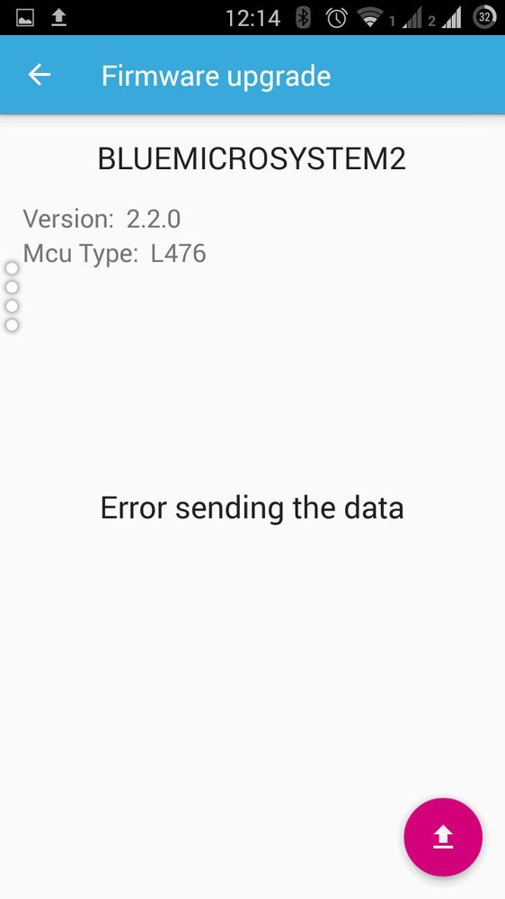

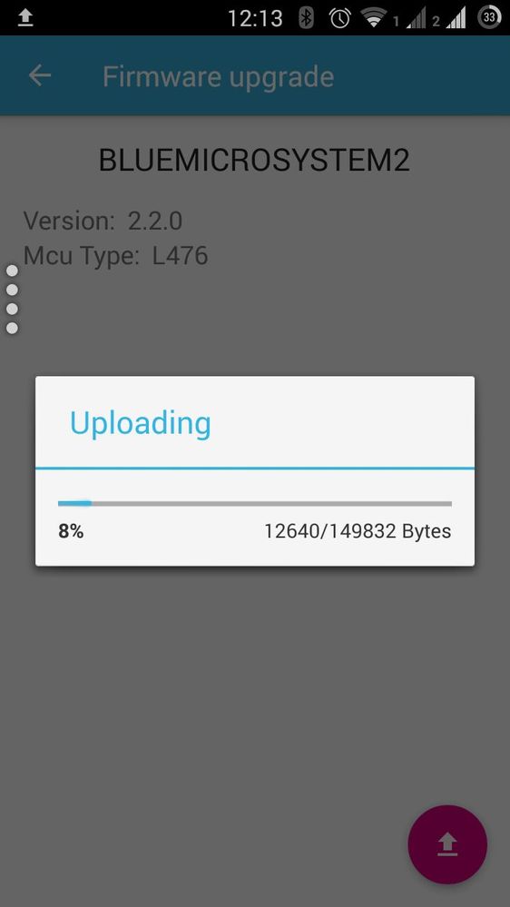

While uploading the binary file, I am unable to flash the code to my stm32l476jgy6 while using the ST BlueMS android app.
The code is uploaded 100 percent but it is not flashed.
Attaching the screenshot for the above problem
Please Help

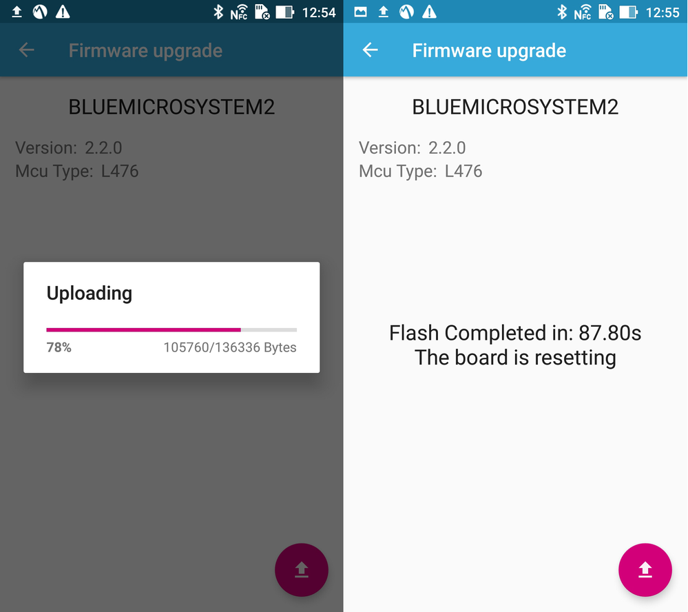

The problem could be the stack bluetooth (Timeout problem) of the smartphone model.I suggest: after the FOTA, reset the board but you do not close the BlueMS app; when the board is reconnected, repeat the FOTA (the speed will be less).
The images below show the FOTA with the ASUS Zenfone with android 6.
