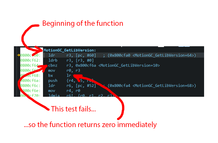

2021-10-11 5:37 AM
@Miroslav BATEK , thanks a lot for looking into this.
I doubled the stack size with no success.
I noticed the MotionGC_GetLibVersion() function fails at its very beginning, after a single test. See here:
If you have access to the library source code, this might give a clue.
2021-10-11 5:56 AM
@Miroslav BATEK, I found my error regarding MotionGC_GetLibVersion(). I was calling it *before* the lib initialization, and it seems it's wrong, despite what's described in UM2181 chapter 2.2.3 diagram. So now MotionGC_GetLibVersion() works.
