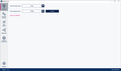

I'm unable to connect my STEVAL MKBOXPROA (SensorTile.Box Pro) to Mems Studio, here's what I get:
"board not identified"

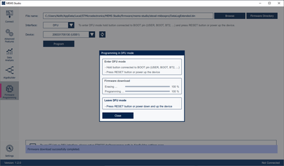

I tried uploading the DataLogExtended.bin, and it says it programs successfully, but I noticed there's a quick "verification failed" in there, and I still get the same problem as above.
Any help on what I'm doing wrong would be greatly appreciated.

Hi @Keef ,
Welcome to ST Community!
The firmware to be loaded must be generated using Algo Builder to allow MEMS Studio to recognize the board and load DataLogExtended.bin
