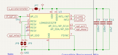

Also below is the hardware connection for reference, v_accelerometer is a MCU digital pin used for powering the IMU.
Operation voltage is 3.3V
I would really appreciate any suggestion/help on this.
