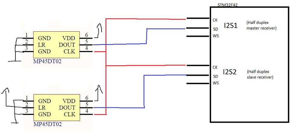

2017-03-30 9:05 AM
Just for clarification: I am using MEMS microphones without WS. It has only DOUT and CLK pins ... no WS.
See picture, is this gonna work as mentioned before?2017-03-31 2:18 AM
Ok so if i would use SPI, i would configure two of them as receive only slaves and i would generate clk for both of them with timer? I have looked at SPI baudrate configuration possibilities and it seems really not much - only one prescaller resulting in hudge frequency (baudrate) steps. I would prefer I2S's smooth frequency settings or maybe i will go for two SPI slaves clocked by timer PWM.
Yes i have heard about DFSDM, but i cant find suitable fast enough mcu within F4 line.
Tthere is a bug in my picture ofcourse, it should have been STM32F427.2017-03-31 6:19 AM
Yes why not but then you need to connect WS too.
I repeat, using the 'fullduplex' I2S couples removes the need for external connecting the clocks.
