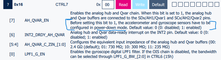

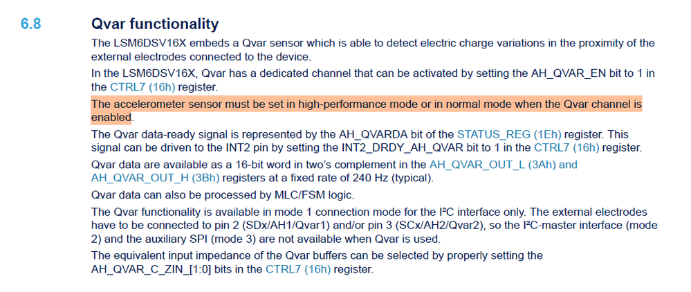

- Additionally, I noticed that the datasheet specifies that the accelerometer must be turned on in high-performance or normal mode, while MEMS Studio indicates that both the accelerometer and gyroscope should be configured in power-down mode (I have attached a screenshot).

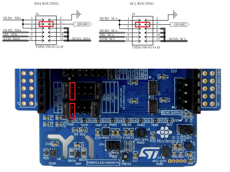

First of all you have to configure the X-NUCLEO-IKS01A4 to connect the electrodes to the LSM6DSV16X. The configuration is described in Getting started with the X-NUCLEO-IKS4A1 or see following image.

Please keep in mind some registers are controlled by the firmware so your modification can interfere with the firmware. This is the case you see the accelerometer and gyroscope and in power down mode. It is because the sensor temporality stopped when reading/writing to sensor registers.
