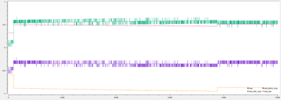

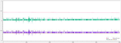

I'm trying to calibrate the gyroscope of LSM6DSO MEMS but I don't really understand what describe the quality parameter in the MGT_state_t structure. I didn't find any information about it in the datasheet. Could you explain it to me ?
I succeeded few times to calibrate the gyroscope but sometimes even with the quality close to 0 (1e-8) the bias are not good at all. Is there a procedure to follow to achieve the gyroscope temperature calibration ?
And when the bias are better, there is always an offset. How can I resolve it ?
