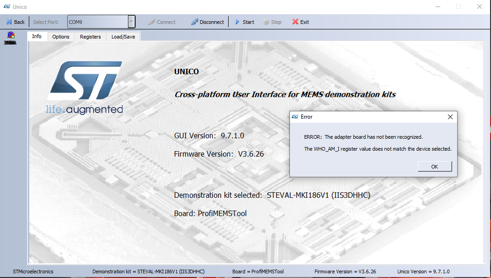

Same issue but with the MKI109V3 evaluation board with an MKI186V1 (IIS3DHHC)
Firmware updated, still no go.

Hi Eleon,
Yes - I have v9.7.1.0 Unico installed with board firmware version upgraded to v3.6.26 via the STM32CubeProgrammer software.
Windows 10 pro 64 bit OS
Regards,

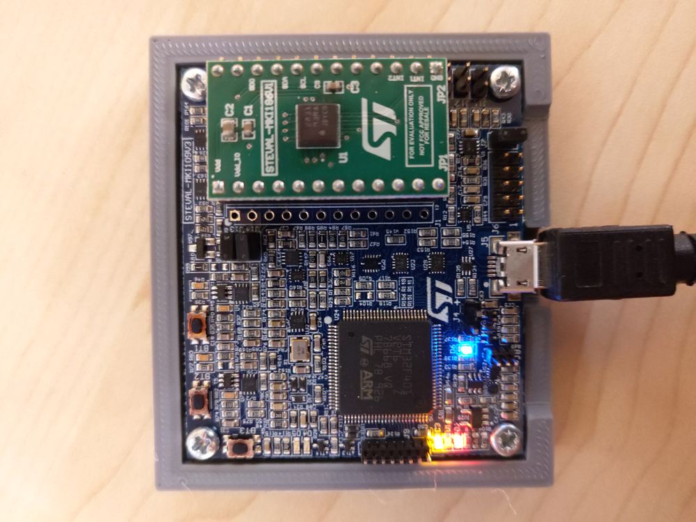

Hi @GTheo.1 , the adapter looks correctly mounted and the ProfiMEMS jumpers are OK... Can you please try with another ProfiMEMS, if you have one in addition, or another adapter? In case of issues, can you try the connection on another PC? Regards

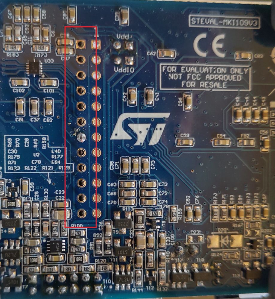

Purchased another MKI186V1 eval board, same issue.
Turns out nearly 1/2 the connections on the MKI109V3 PCB header were not soldered - pic below. Posted the solution here in case others have similar issues:
