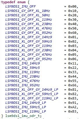

The output data rate that you sugested is not available for the LSM9DS1, since it only works with the gyroscope turned off, as you can see below from the drivers:
I did set to 59.5Hz since it is the closest data rate available for both accelerometer and magnetometer. I set the remaining values to the ones you indicated. Still, the issue persists and I don't really think it is because of the data rate.

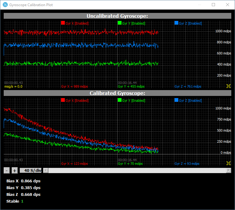

Unfortunately your datalog doesn't contain accelerometer data which are necesary for calibration too. Please update the datalog.
Hi, Petr,
You're right. Sorry. Please, check this new one.
