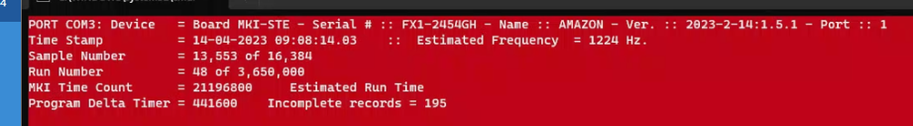

The second issue is that I have the ten accelerometers running on about 8 NUCS. They are all as identical as I can make them, same parts, same windows and they are in the same location on the same network for 7 and 1 on another network. The picture shows them running at 1224 Hz for this one, they run in the range of 1200 to 1450 Hz for the 1666 setting. I am measuring the running every 8 seconds and once they settle down - usually a minute they are stable just not at 1666. The issue is the different frequencies mean that the FFT has different steps. We want to use this to measure structures so a constant FFT step size would be nice. I can live with this, but UNICO-GUI does not tell you what frequency you are running at in reality as it does not return the timing function.
