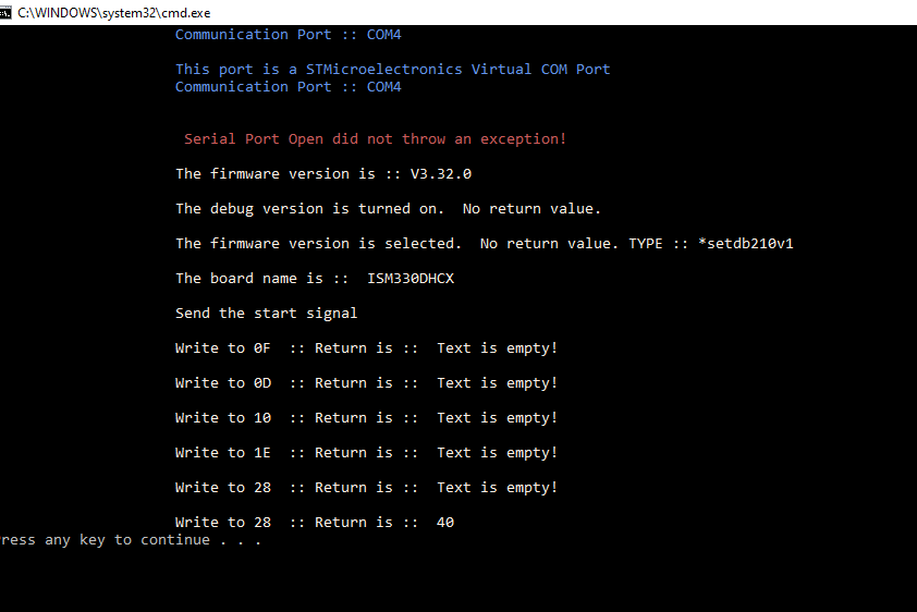

sp.WriteLine(writeWA3 + "\n\r");
text = sp.ReadExisting();
if (text == "")
text = "Text is empty!";
Console.WriteLine("\n\r Write to 1E :: Return is :: " + text, Color.Linen);
Anything but ReadExisting hangs the code.
A sample of the output.
I have written a lot of code in C# for accelerometers, this is the hardest so far.

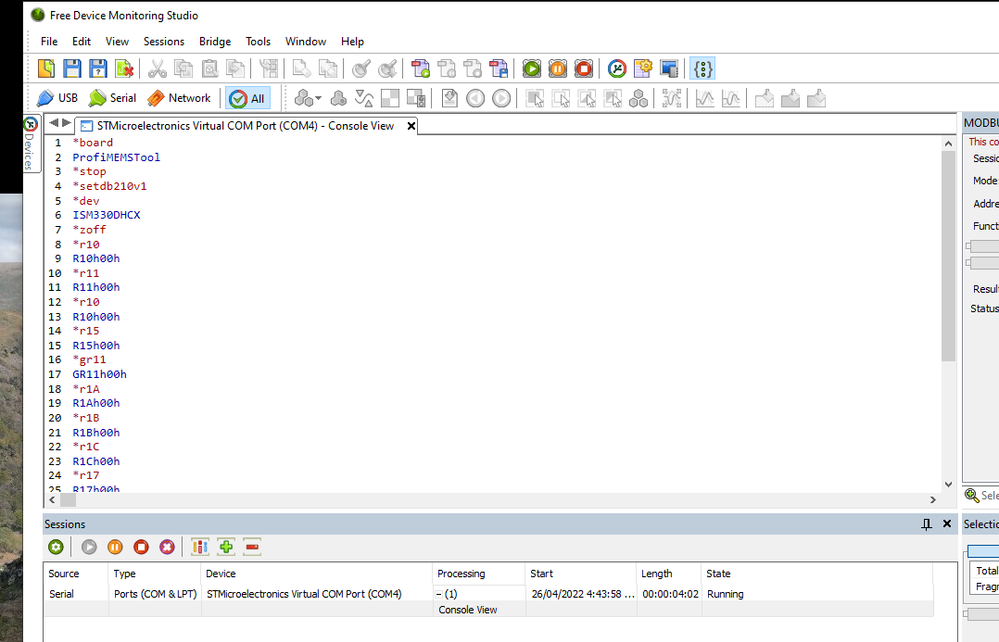

I downloaded a port sniffer and fired up the old UNICO GUI. The data after the port is opened.
So this is the long hard way, but it is ok.

I fail to understand why UNICO GUI needs 156 writes to registers to set only a few.
Also UNICO GUI sends a
static string writeVDE = "*ver*dev";
which I fail to understand.
