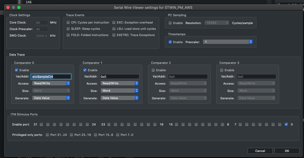

I am using STWIN-STWINK1 for a predictive maintenance application, I am unable to set up SWV ITM data console and trace on STM32CubeIDE.
I tried following all the tutorials on YouTube and community, nothing works. If anyone has been able to get this through please let me know or share the configuration.
Many thanks in advance

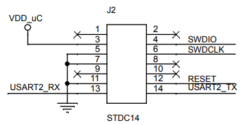

I'm wondering if the SWO pin, required for Serial Wire Viewer (SWV) trace, has been wired on STWINKT1 board... This is an optional pin, as declared by the ST LINK V3 user manual.
The schematic of the application board doesn't seem to include that pin... this may cause the miscommunication.

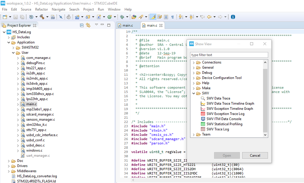

I find the SWV comsol in Window - Short wiew - other - SWV, and then select for example the SWV Data Trace.
For a tutorial on how to set up the proper variables to be monitored, you can refer to this video.

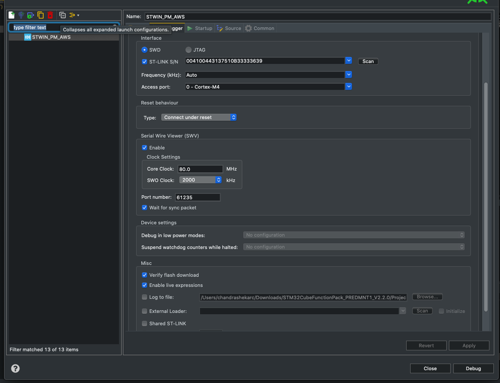

I am trying use SVW console for STWIN_PM_AWS application, instead of terminal, I wan to re-direct all the messages to SVW console.
Here is my debugger configuration

Hi @Chandrashekar C ,

HI @Eleon BORLINI,
This means we can't log printf data to SWV Console on STWINKT1 board?

HI @Eleon BORLINI
I am already doing this, I just wanted to print into SWV console while I am debugging.
Looks like with STWINKT1 its not possbile :(
