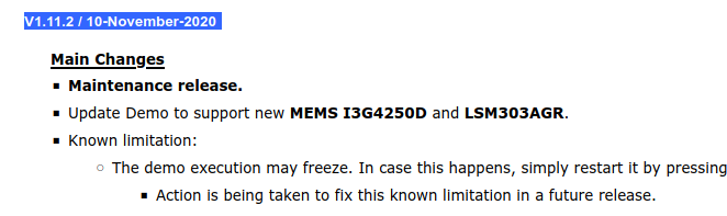

I had a STM32F3 Discovery board which version label is "MB1035-F303C-E02" and its Compass mode is LSM303AGR. But I found the code in STSW-STM32118 is use LSM303DLHC, and the demo code not work. Where could I get the latest demo code for STM32F3 Discovery board ?

the latest cube should have it:
(from : STM32Cube/Repository/STM32Cube_FW_F3_V1.11.3/Projects/STM32F3-Discovery/Demonstrations/ )
https://github.com/STMicroelectronics/STM32CubeF3

Thank you very much, It works!!!
