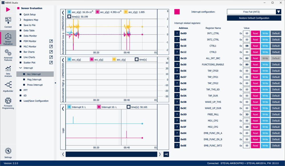

While logging the High g and Low g accelerometer sensor, in the csv file i could see the Interrupts printed from INT1 ro INT10. Only in INT10 i could see the value changing from 0 to 1, Would like to confirm that this is the free fall detection interrupt. Hereby attaching the log for reference.

The logical signal Interrupt 9 in MEMS Studio reflects INT1 of the sensor connected in DIL24 socket in your case LSM6DSV320X and Interrupt 10 reflects INT2 of the sensor.
So it depends on your sensor configuration, whether the free fall detection interrupt is routed to INT1 or INT2, both options are possible. You can test in on the Acc Interrupt page.
