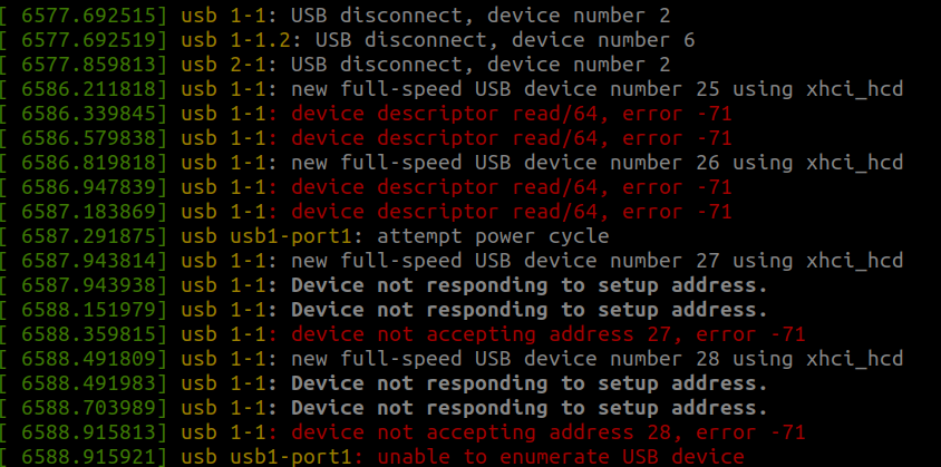

Thank you very much for the prompt reply.
Yes, there has been a reaction. In the picture you can see what happened when I replugged the the hardware. 0693W000000VidJQAS.png
Uwe Bonnes
Chief
Stlinkv2 has a fixed pull-up on USB-DP, causing the system to try to reenumerate. The Stlink does not react on the reenumeration requests. Just to be sure: The target board is disconnected? Is yes, I think your STLink is defunct. Did you perhaps wrong wire something and external volatage > 3 Volt or < -1 Volt got applied to the Stlink? This is the only way I killed STM32s. If the target board is still connected, retry with the target board disconnected
