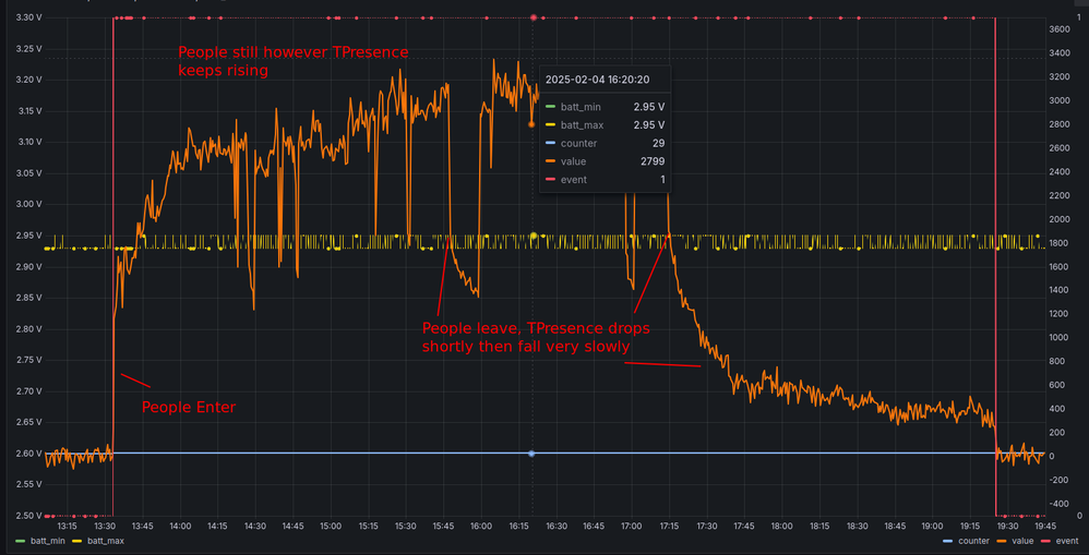

I use STHS34PF80 for presence detection with embedded algorithm however it easily get stuck in presence status and cannot release from the status.
Use case:
People sit in from of the sensor around 30 cm, with lens on STHs34PF80.
When people enter the FOV it's triggered as presence status.
When people sit still for a while (e.g. 30 min), the TPresence keeps glowing.
When people leave, TPresence drops however it cannot across threshold.
TPresence will keep fall very slowly until it across the threshold however sometime it will never across below the threshold.
Red line: presence flag
Orange line: TPresence value

Any idea why TPresence keeps rising when people sit still and fall very slowly after people leave ?
And how to solve the issue ?

What's the possible cause of the rising TPresence value after presence is triggered ?
Due to the keeping rising TPresence, finetune the PRESENCE_THS and HYST_PRES doesn't help since if you use high threshold it will be difficult (or takes time, latency) to trigger presence status.
And if you use low threshold you will get stuck in presence state since raising TPresence value will never across threshold even people leave.
I want to know what's the cause of the rising TPresence value and how to avoid that.
(I changed ODR, lp filter however it seems doesn't help)

This means that the presence algorithm will only be correct when the PRESENCE_THS value is set to high and the person is close to the sensor. The further away the person is (low PRESENCE_THS), the less accurate the result will be.
Can you give me the PRESENCE_THS value and the distance at which the presence algorithm works correctly? Because for me it is only accurate between 1m and 1.5m, in an empty room with only me. I am testing with UNICO-GUI software and STEVAL-MKI231KA

The environment is stable, no ambient temperature chage
There is no heating up object within FoV
however TPresence is still raising.
Is there other possible cause ? or does the sensor take human body as "heating object" also ?
