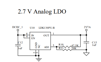

On the STEVAL-STWINKT1B board, and using the HSDatalog firmware, it uses about 60mA in idle state. I have disconnected the sensors, and the uC, and turned off the SD card power lines, but it's still at around 2mA. Does anyone know where this power is going? Ideally, I want to create an application for the board when it wakes up for 1 minute in every hour, logs the data to the SD card, and then goes into a nearly dormant low power state to preserve the battery.

Hi @LWeir.775​ ,
In the current design, unfortunately, the 2.7A regulator cannot be switched OFF, so also the connected OpAmp is always ON.
The only option would be to de-solder it, or de-solder the OpAmp which accounts for more than 1mA alone.

Hi @LWeir.775​ ,

Hi Eleon,
That was our prime suspect. Thanks. It is frustrating given what we want to use the board for. I think we are going to try and reconfigure the power supply to the 2.7v LDO such that it comes from DCDC2 instead, and so is switchable. Not an easy mod and frustrating the board doesn’t have it as a configuration option.
Hi @LWeir.775​ ,
The DCDC converter provides the supply the microphone, so this would be the only component that would be excluded removing the LDO.
We are however designing a rev2 platform, and we will take it into account this issue.
-Eleon
OK. That makes sense. Unfortunately the microphone is key to our project. What are the current project timescales for release of a rev2 board?
